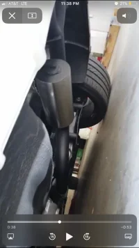

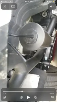

They only way you can get the roar without drone is by adding side silencers/helmholtz resonators.
D5F87A70-A041-4E10-8839-A7DC7E3F2F76.webp 665EAF97-C795-478F-AFE5-1BA519D4D8BE.webp
My exhaust shop just quoted me about $700 for this setup and guarantees 100% NO drone!:thumbup:
If/when you do this can you get part numbers / dimensions on the resonator? I asked the OP of that video and he didn't throw anything back out there.
I don't know that there would be a part number per-say as I think they custom cut the length to tune it for a specific frequency. But maybe there is a 24" long silencer kit P/N XXXXXXXX that was cut to 19.5"
If not then dimensions might be the only thing that we can get. Thanks in advance!
