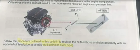

It actually does, you can see the reflective sleeve, almost touching the top right corner of the turbo heat shield. I tired to check mine but it's too tight in there, need a dental mirror or something to see under the double tube above it.
Yeah good eye. I see it now too.
I too am waiting to see what the replacement procedure looks like. I'm assuming they attack it from under the car as you can barely even see this line from the engine bay and there is a lot that would need to be removed to access it from there.
Definitely will not be the first customer to book my car in for this replacement. My recommendation to everyone is to wait until your local dealership has mangled a few cars before booking yours in, unless you are certain yours is leaking.
I could barely just see it with a dental mirror. Easiest way is to reach under the two black double tubes by the turbo heat shield and you can feel it with your fingers.
NO BLOODY WAY you're getting to it without either dropping the engine or disassembling half of it, that line is tucked under there like a can of worms.
Good call waiting it out for some guinea pigs, anything to improve your odds at the kia dealerships...

My 2018 showed up for recall too. Saying it would take 3hours or more. Not doing it. At least for now. Edit: went to Kia of Mentor today to order serpentine belt. And on my way out stopped by service department to ask about that recall. The guy told me, they've done several of them, and his technician would need 1.5-2 hours with the car to do it. And obviously, the engine won't have to be removed.

I had my car in for service, a U.S. 2020 stinger gt 3.3t, and the dealer said the car needed the recall work to replace the oil feeder hose and pipe. The work took three hours so I am pretty sure they did not drop the engine or anything that major.

Also now listed for the March 1 2024 oil feeder hose recall. I will also be waiting to see how dialed in the recall steps are being performed by the dealers. With the cruise control fuse issue a few years ago, a new fuse module was created that made the recall so easy to perform I was able to do it myself, versus the convoluted rewiring the original recall outlined. There is hopefully some similar shortcut here.

Exactly my approach. Although I plan to wait until I see smoke to get this one done, unless they come up with some super-slick way to do this without taking half my engine apart but i'm not as optimistic as I was with the HECU recall. That one I thought was idiotic from the start and posted about how a new multi-fuse would be much cleaner and then Kia saw the light and did that instead too.

Hopefully someone soon can post the full procedure - so far only have the 1st page, which doesn't detail anything technical
