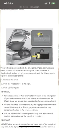

No, that is a good question and yes I leave the hatch open before I close and lock the doors. I typically pull the hatch down to just before it latches while I let it rest. I do that to keep the flies out of the car. If the hatch accidently latches then it will be a pain to get into the car so make sure it doesn't latch.So after you close and lock the doors how do you get to the battery? Did you leave the hatch open. Sorry bear with me pls.
