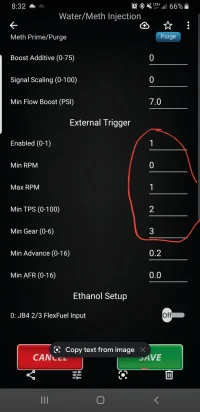

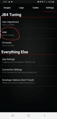

Enable mode 1, which is the only mode you can select currently in the app, leave JB4 enabled while wipers run. Later we'll enable mode 2 which is the same as mode 1 only it disables the JB4 when wipers are enabled.
Thanks. I'm still trying to figure out this: if I set up my map settings as 0, 1, 2, 3 for stalk positions 1,2,3,4, and then turn on wipers and adjust sensitivity, and then turn off wipers - does it trigger a map change to the new stalk setting?
I don't always have E30, so I wouldn't always want to engage map 3. But I might need that setting for sensitivity in case of a small shower. Do I always have to return the stalk setting to 1 or 2 to get map 1 or 2 back when turn off the wipers?
