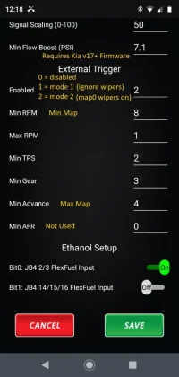

When I attempt to enter a value of less than 0 ( like .4) for the last column it resorts back to a whole number and map 1 becomes the result of the highest intermittent setting
So it goes 0, 1, 2, 3, 1
I tried to enter .5 for map 5 and it switched to a whole number when saved and made then the highest intermittent setting became map 1 again
If I enter .5 it will error out and requires me to enter a whole number. then will save and the highest intermittent setting becomes map1. No matter what.
Running 17v

Also when wiper switch enabled I can’t change maps through the jb4 App, map can only Be changed through the wiper switch. When I disable the wiper option I can revise the maps through the jb4.
This seems all result of 17v update.
Either I use the wiper switch or the jb4 for map changes....worked before so I’m confused. Sorry for all the posts but I keep finding stuff that confuses me a bit.

That's expected, when the wiper map switch is enabled that is the only way you can change maps.
OK, that makes sense, can you advise why I am unable to put in a number in that last box that will allow me to make the highest intermittent setting anything else but map one? When I attempt to put in a variable less than one, like .5 it won’t except it. I would like it to make map eight available on the highest setting, but it keeps reverting back to map one or errors out when attempting to write the data
Might be a bug in the interface, waiting for that to get cleaned up to optimize it for it's new purpose.
