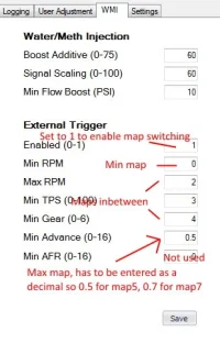

Working on getting the app interface updated to make the setting entry a little easier. This is currently how you enter the maps to select on the wiper setting.

I have the wiper setting as 1, 0, 1, 1, 2, 0.2. It is working as intended, but it keeps the map settings even when the wipers are on. It even switches map when I change the intermittent setting on auto/lo/hi. I am on v15 firmware. Any setting to turn off jb4 when wipers are on?
Not yet, too many people cried about racing in the rain. Next app update we'll allow "enabled" to allow a setting of 2 which will enable the feature with JB4 going to map0 when wipers are on.

Loaded up v15 firmware today and went on a drive to do some testing. I setup my switch for maps 0-4. I too noticed when running the wipers it retained the current map, which is my preference. Everything seemed to work as advertised. No problems switching maps while driving and it was accurately reflected in the JB4 Mobile app. Couple questions, is old map 7 now the new map 5 and these settings wouldn't change anything with the WMI installation correct?

Enable mode 1, which is the only mode you can select currently in the app, leave JB4 enabled while wipers run. Later we'll enable mode 2 which is the same as mode 1 only it disables the JB4 when wipers are enabled.
