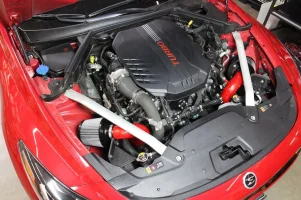

How could that possibly be considered a “Cold Air Intake”? The filter points back towards the engine and it appears that the “heat shielding” only protects it from getting the cold air through the factory inlet.
Am I missing something that isn’t visible in the picture? Is there a new cold air inlet that it utilizes. Perhaps something in the wheel well?
From that one picture it just looks like the perfect setup if you want to ingest as much hot air as possible.
Those cross braces get really hot too and they appear to go right next to the filter. I would be curious to see how this setup performs in real world acceleration tests. I am sure it flows air faster but I am not so sure that it really is a cold air intake.
The entire bottom sides and back are enclosed in a metal box , the factory air inlet from the grill feeds right into the box the box keeps the heat out

Can you take and post some more pictures of this Stillen setup? I am curious if it utilizes the stock intake tunnels through the front bumper. Does this air box seal to those factory intake channels?
Also have you installed snorkels on your car or did you leave the factory intake snorkels there?

Could you post a top down picture of this? I couldn’t see that from the picture that was posted. It still doesn’t seal the filter off, right? It just acts like a shield instead of totally isolating it from the engine bay like the factory box does?
OK, I see now. The picture below makes it clear how it is still utilizing the factory inlet. From the picture you showed it really looked like it was blocking it off.
No snorkels , factory air ducts

I saw the same thing as you but after looking at the company web site is seems like the cold air inlet are still flowing to the "isolated" area. Still it does not seems to be the best option out there in term of isolation nor size of the filter.
It doesn't seal to the factory tunnels. You remove the tunnels that are in the engine bay side and bolt to the chassis at or next to those locations. I took as many photos I could of it. IMG_1198.webpIMG_1199.webpIMG_1200.webpIMG_1201.webpIMG_1202.webpIMG_1203.webpIMG_1204.webp

AEM has a very good design, seals the engine bay and uses the factory intake tunnel. With snorkels it could be considered a true cold air system.
