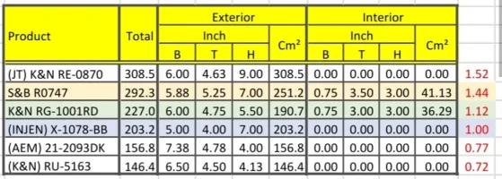

The filter area is 44% larger than the origin filters that come with the Injen CAI. My goal was to match the filter size of the JT intake kit without having to change my CAI. These large filters are slightly smaller (292cm2 vs 308cm2) than the ones that come with the JT kit but come very close.
FYI they are exactly twice the size of the K&N intake kit.
More numbers:
