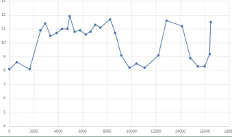

My average fuel consumption in liters/100km. Horizontal axis is total km at that moment. You can clearly see when problems occur.

Which value is that? Calculated yourself on fill-up? Total stats of the car? Did you reset them every time?
From stats on the car. But I calculated it many times to compare and it was correct. I did reset them every time.
