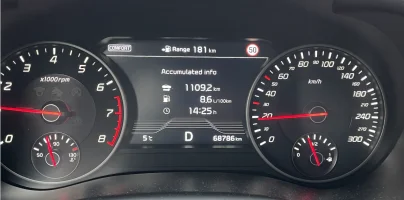

So, update after 2.200 km with the new ECU. I've just been to the dealer for a follow-up and the data shows that the car has successfully made at least one regeneration since the ECU change. Before that, it had never made one without the error light coming on in the dashboard.
They recorded the data and sent it to KIA. They consider the regeneration problem solved but asked me to keep the car under observation.
While driving, I haven't noticed any other stuttering or interruptions, which had become very noticeable before the ECU change (while the car was attempting regeneration). Still, when the engine is cold there are still rpm variations but not nearly as bad as before (the video from my previous post). The KIA engineer mentioned that this cold start problem is still under revision at KIA and another future version of the software might make it even smoother. Don't know.
As for the fuel consumption from my ski trip, going there I drove pretty fast, with a lot of overtakes (many 80-130 accelerations) and 130-150km/h on the highway (about 50% of the way). The consumption was 9,3. My friend with a Golf MK6 GTI got a 9, under the same conditions.
Coming back there was heavier traffic so we were much more relaxed. Same speed on the highway but very few overtakes and overall speed was much lower. Consumption was 7,8 (the GTI got a 7,6). Overall it was 8,6. I am very satisfied with this.
