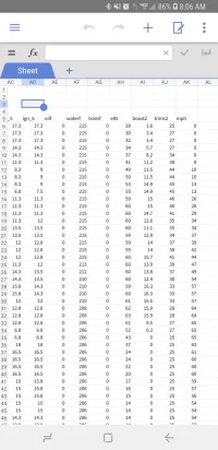

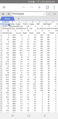

I tried it again last night and was able to leave on 11psi according to my jb4 log. Screenshots attached. This was on an incline as well, AWD, k&n filters.
Can you add a screen shot that shows Throttle, RPM and boost?
Holy crap. I don't think I've seen anyone come close to this yet
I've hit 1.83 many times but 1.80 is definitely the fastest.
