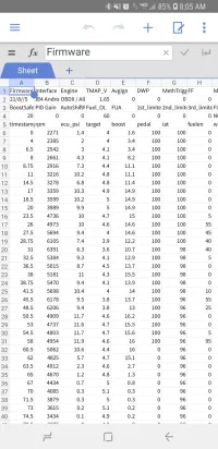

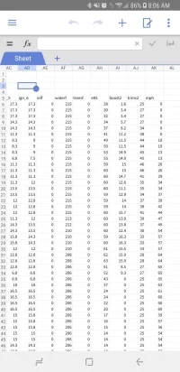

I tried it again last night and was able to leave on 11psi according to my jb4 log. Screenshots attached. This was on an incline as well, AWD, k&n filters.
Wow thats impressive and makes me even more jealous of you lucky AWD Stingers!:(:rofl:

It surprised me for sure. Chirped the tires in sport. Curious if going to custom and setting the transfer case to comfort would change how it launches too
