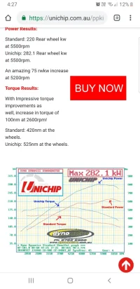

Hey mate...they have done it for stingers before. Increases kw at the wheel by 62kw just with chip and tune or at the fly by 90kw...have a read and let me know what your thoughts are

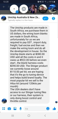

FYI from unichip directly
" the reason some of the USA Stinger forums are suggesting to regap spark plugs is because they are not controlling all the tune parameters. We have no issues what ever with stock plugs and stock plug gaps. Our system doesn’t communicate with the factory ecu doesn’t leave any form of electronic footprint and is IMPOSSIBLE to tell it’s ever been connected "
Weird, Unichips USA website doesn’t show anything for the Stinger. Are you sure those dyno results are from an actual Stinger? If they are, then those gains are on par with most piggybacks.:thumbup:
It's not just plug and play this one I don't think...it's a whole new ecu? I'm not too versed in it all though...just check out the site and let me know your thoughts on the product...the performance is there
The link you provided above says the q4 is a “piggyback” so it’s not a new ECU or what’s considered an ECU tune like Tork or PresserTech. It’s the same concept as a JB4 or Lap3.
Sorry but this is incorrect and is technically false advertising. The JB4 and most Piggybacks control the same exact parameters. Even unichips website states the chip is a “piggyback” and shows all the same adjustments the other piggybacks manage as well.
The only upgrade that can control “all the tune parameters” is a real ECU tune like Tork & PresserTech but they are full ECU swaps, not a piggyback like the q4.
Lastly, our spark plug issues are not caused by certain chips/tunes since even some stock Stingers had the same problems. Some cars were gapped properly and had no issues, while others had .030”+ gaps and had misfires even with stock boost levels. Extra boost just exaggerates the problem which is why it’s a lot more common with chips...
