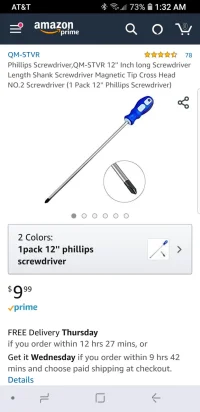

By any chance you have a link to that tool? Thanks
This screwdriver was posted by another forum member to adjust the headlights. Don't know if it's the same tool that eflyguy uses, but I got it and it worked very well for me.

No. After adjusting, the dynamic bending headlights feature worked just fine. When using a screwdriver to adjust, make sure to lightly seat the screwdriver into the ajustment screw, then apply slight pressure as you turn the driver so you dont strip the teeth of the ajustment screw. I believe it's made of plastic.

I just finished adjusting my headlights. Lol I thought I was stripping something since I applied force.. GG I hope the nut in the back still works if needed later down the road .it looks decent I guess. Haha I adjusted 2 inches higher at about 3 feet distance from the wall since that's all the room I had in my garage .
