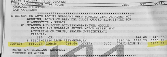

I wonder how much the halogen headlight costs.
1 single 2018 LED headllamp assembly with DBL + auto leveling lists for $3630.29 CAD (about $2670USD)
Ouch!!! Those moving lights only came on the gt1 and 2? Right?
Wow, even the kind that don't move must be pricey. No stock or prices at the parts stores
