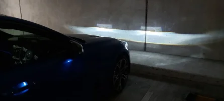

I finally got around to adjusting mine. So much better now I regret not doing it over a year ago when first I got the car.

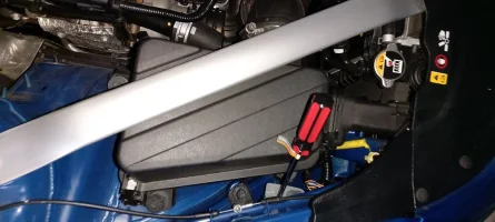

The cheapest long Phillips head screwdriver from Bunnings was all that was required. Insert in to U/D hole & turn clockwise (which turns the bolt anti-clockwise). The tip of the screwdriver is turning the gear at the bottom of the hole. Quite a few turns were required.
Hopefully I've not gone too high now. :p Reflections from the street signs are a lot more noticeable now.

I just did the adjustment on my lights using the "horizon" method. It was super easy, using the "funnel" and the long-shank screwdriver referenced above). Took maybe 2 minutes each side. I'm anxious to see tonight how they do on the road.
For the record, my 2020 GT2 has headlight centers ~28" from the ground. I marked out the same height on the back wall of the garage, and parked the car at ~20'. Adjusted the lights up until the tops of the "hot spots" were at 28". The hardest part of the whole process was finding a screwdriver that would fit the darn hole!
