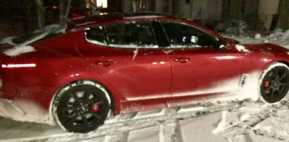

Looks like somebody's been out enjoying their car in the white stuff - with the right shoes, she's a pleasure to drive in the wintertime, that's for sure ... :thumbup:
