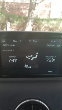

ok so my drive was on and off all day and the last leg of the day was about 30 miles mixed driving
outside temp in the 50,s
AC came on set at 73 ish

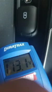

In tray

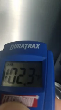

on sliding door

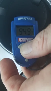

cup holder
