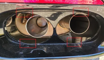

Has anyone already, or can someone provide me with a decent step by step guide to trim the diffuser for round tips?
Not really a guide but if you are getting large round tips 89MM outlet carbon fiber ones like these you'll need to trim a bit from the top and bottom. Best thing to do is see how they fit and trim a little a time with a Dremel. I went overboard and ended up not using round tips because they still made contact with the diffuser and caused vibrations. The red shows where I had to trim with a different exhaust that's shown, and it will be different for everyone anyways.

You could also get a smaller outlet like 76MM and not have to trim the diffuser at all. Doesn't look all that good imo though.

This is why I recommend the oval tips. They don’t require any trimming so they don’t rub on any part of the diffuser. They are also about the same outlet diameter as stock so look good.

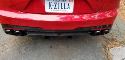

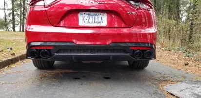

I have the 89mm tips, trimmed the holes and while there is still some contact, I don't get any noise at all. I've had the exhaust since the beginning of Feb.

you dont get any rattle and cant feel any vibrations?
Correct. No vibrations, no 'rattles' of any sort. If there is, perhaps those people need to trim more. While there is some touching/rubbing, it's very minimal, nothing enough to cause noise in my opinion.

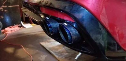

for those that had their tips welded on, do you guys have pics of the final end product?

Why do you want to weld them on? That would mean that you would have to cut your exhaust in order to remove it. The clamps work just fine as long as you tighten them well enough. I've ran 3 sets of tips now and haven't had a single one loosen up on me.
