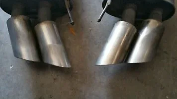

I'm old school like that too. they haven't arrived yet, but...
US $27.0 10% OFF|1 PC Car Accessories Outlet 105 mm Oval Stainless Steel Universal Exhaust Tip Muffler Pipe For Reiz Carola|Mufflers| - AliExpress
make sure the inlet diameter matches your MBRP tips. I ordered 63mm type A tips for my Quicksilver only to find out I should have probably gotten 60mm. we'll find out when they get here in a month.
I can't get the blasted exhaust wrap to stay in place. it'll have do until the tips get here. Did drop the drone almost entirely.
Awesome! I'd love to see pics when you get them installed.
Also, have you tried using hose clamps on the exhaust wraps? That's what I may use if I stick with stock tips.
oh I am using clamps. they haven't moved since my last attempt, but i've only driven the car once. we'll see if they stay. sound reduction in the car is huge with the wrap in the right place.
Good find! I got a set in 60mm in my cart (I'm also on the Quicksilver train).
I was hoping to find something with a little more aggressive angle that still fits and is still in stainless. Something akin to the quad exhaust on the old Acura TL-S, which I've always admired. Unfortunately I haven't really come across anything.
