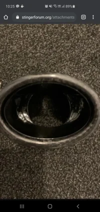

Can you see the extension tube inside the OEM tips? Got any pics? This is intriguing
they took a piece of SS tube, same diameter as the borla muffler tip, and welded. If is bigger then it will touch the oem tip inside and posible vibrations.
I can be a little longer, but then it will be more exposed...at least the drone is gone!
