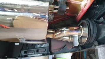

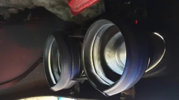

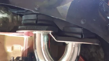

Images for an earlier discussion point... for "connecting" aftermarket muffler to the oem tips
[this was my fix that actually eliminated my cabin drone, might help others]
What material did you use? And link?
On MUFFLER plates;
12mm EVA foam rubber (sticky-backed) on the muffler plates... at local hardware shop
On OEM tips;
18mm door seal pinchweld (outer tips) & 26mm pinchweld (inner tips), as the gaps to the plates differed... sourced off ebay

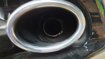

I have the oval Akrapovic tips, but the exhaust isn't perfectly aligned so it rubs just a bit. I have a few random rattles now and then, wondering if this would help eliminate them.
