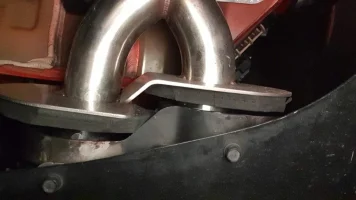

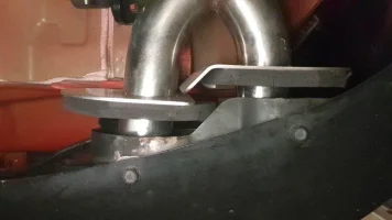

Sure man, will do soon... my hot tip though; close the gap around your pipe too, if not, the exhaust sounds will still go back up under the car. And for some reason the back of our stinger's seems to act like a big fkn megaphone - my guess is the trapping of exhaust noise and the reverbations under there, then translate into the chassis and cabin = drone. Good luck.
Here is the pic (hot and cold) before I installed the pinchweld on the other side (i.e. fake tip opening). Installed some 10mm foam rubber (seld adhesive) on my mufflers backing plate, which is similar in design to the plate on the oem kia mufflers. The pinchweld seal sits against this now.

Nice! Did you make that backing plate? And where is the 2 other picture? Is not showing though.
No, those plates comes with those mufflers.
Sorry no other images there, I tried to link them first but failed, so inserted/attached instead. I will upload more pictures of the pinchweld install later.
