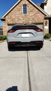

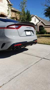

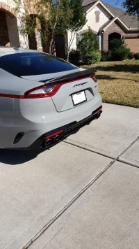

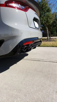

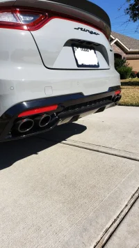

After removing the stock exhaust and having a local exhaust shop fab up the muffler deletes as to my expectation, there was a horrendous amount of drone. I read numerous ppl talking about exhaust wrap, but I initially tried some exhaust extensions which brought the tips a little further out within the stock faux tips. That helped quite a bit, but drone was still noticeable. Bit the bullet and ordered the AK tips 51-105 carbon glossy. Quick deliverey from Ali, about 7 bus days. Just finished putting them on and it honestly reduces the drone by 90-95%. Nice deep tone that is only noticeable inside to say you have something done, but pretty quiet. WOT sounds perfect. Don't feel the need for anything else as far as exhaust now. Like the looks as well.

Great to "hear". haha.
Looks good too.
Looks good! Glad the tips took out the drone for you, too.
