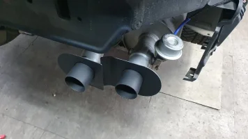

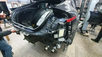

wow ... surely this is not JUST for the exhaust tips.... WAY overkill :eek::eek:
I’m thinking there must be something else going on here. What’s this little guy; some type of vacuum actuator for active exhaust?
Could explain the bumper removal. IDK though.
good eye ! looks like EVC system... jun bl maybe (since op is in Korea)
Yes its an EVC catback.

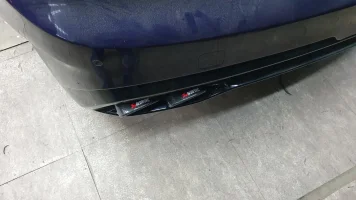

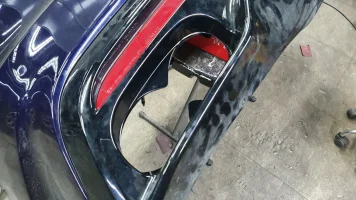

We removed the bumper to do the trimming, and we also painted the original muffler tips in black to be more stealth when looking through the trimmed bumper.
75x105
but I think I should have gone for a smaller size
I get a sort of rattle at idling 620RPM, I think the tips are hitting the bumper at that engine speed.
I must warm the community:
Tips may reduce the drone, but they change the note of the exhaust, thing that I didn't really expect.
To be honest the exhaust sounded better before doing the tips, both valve opened and closed.
Now it sounds different and louder on the outside, quieter inside (not speaking of the rattle because it is probably an easy fix).
So if I could speak to my past self before ordering the tips (or to anyone in a similar situation) I would say: Only do it if you can't live with the drone!
In conclusion I am a little bit disappointed right now but I couldn't do much testing, so I will update my opinion after more driving.
