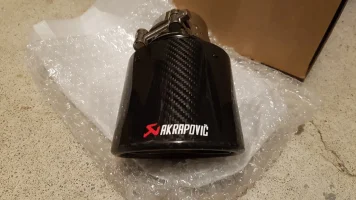

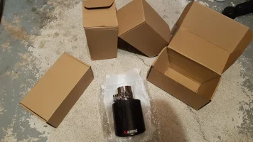

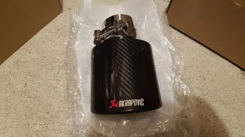

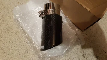

Just the tips are in...
Received a special delivery today.
My Akrapovič tips arrived!
Ordered on Nov 11th.
63mm in Size B
Awaiting MBRP SS Exhaust. Ordered Nov. 20th, w/ a ship date of Nov. 29th.

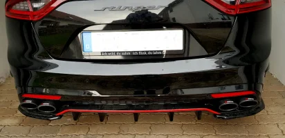

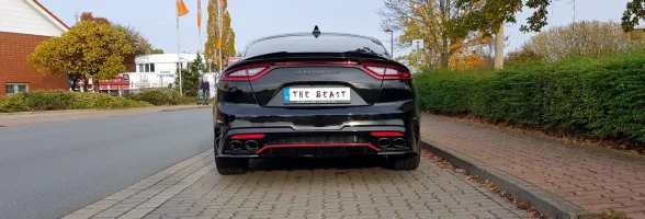

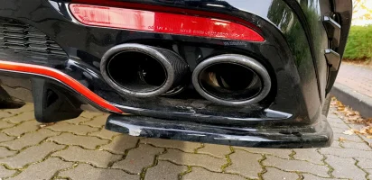

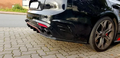

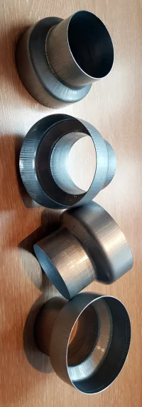

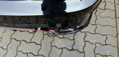

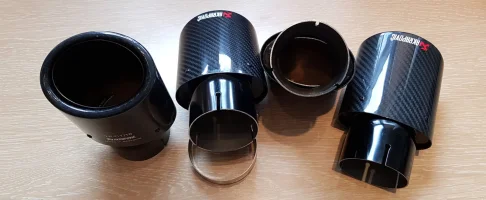

Cause of German laws i had to fit the "new" tips to the original tip holder. Cutting the original out and welding the new ones onto it.
Added a new collecting funnel to each too, to avoid humidity and exhaust gases crawling behind the rear skirt and cause problems and bad smell in the car.
So no direct contact between the exhaust and the new tips was needed. They are fitted into the reart skirt like the original ones. 7,?x10,5cm will fill out ecact the cuttings in the rear skirt, like the original tips does.
This will be eventually a solution for all user having trouble with the fitting (diameter, length).
The "collecting funnel" pieces are narrowing for a rain gutter.^^
Sorry for the dirty car and bad english. ;-)
