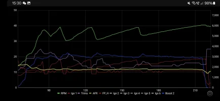

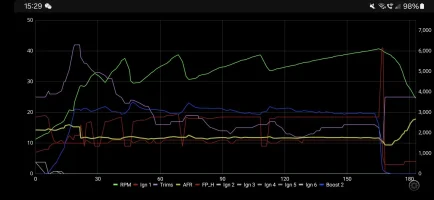

Steady AFR will smooth the car by a little bit and timing at shift will shave off the 1/4 time by a noticable 0.2-0.3s. WMI can run use pure ethanol or pure methnol depends on which one is the cheapest available too. Here's some 17deg vs 19deg BEF screenshots and you can see the mid end timing I'm talking about. It's peaking at same timing but mid end(after shift) is night and day difference. That's why I say 19deg would be a problem and 17 might be just fine.
