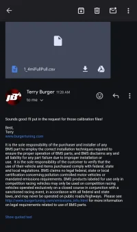

Just in case anyone hasn't had any experience with Terry.. I emailed him today, on Saturday, about adding my calibration ID for his TCU tune and he responded within a half hour... if you're on the fence about any of BMS's products, don't be.
100%! I’ve been bugging him multiple times per day several times a weak. He always responds quickly and is pretty patient with my questions. I have his new TCU tune and the 85/19 BEF. Am going to put over 800 miles on them this weekend. So far so good!
Not surprising at all others have had the same experience! How's the TCU tune feel initial impressions wise? I'm excited to get mine flashed.

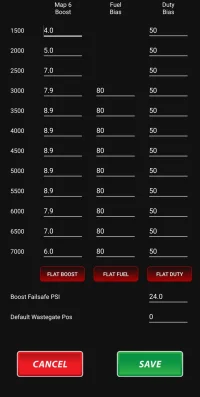

Messing around a bit with Map 6.. attached a log, it's clean but definitely spiced up. Absolutely loving it though coupled with the BMS E85 Race BEF.

What settings to I need to change to try MAP6 on an E60 mix?
So if you look at my first post I also posted a screenshot of my "user adjustment" screen for my settings for Map 6. I'd bump all those down by one (ignore the .9s, for some reason my app doesn't like whole numbers so read it as if it were rounded up).
That's where I started based on Terry's recommendation but for my car it didn't make hardly any difference from Map 5 so he had me bump every value up by 1 which initiated face melting mode.
I'm referencing left column "Map 6 Boost" just to clarify. Match the other two columns that I have if they aren't matched already. I don't remember if that was pre-populated in there or not initially because it's been awhile since I first tried it.
Sorry if that was a muddy mess of information. Let me know if you need clarification.
