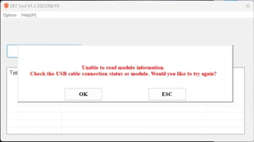

Howdy. Forte 1.6T driver here. I just received my EK1 pro recently and I'm here looking for help. Forte forums are not very active.
Long story short, I went to update the firmware as instructed from SXTHNK so I could read my ECU ID. The firmware update messed up the UI of the EK1. All the images are jumbled. Nathan provided me with a .exe tool to correct the issue, but I'm having a hard time getting the tool to recognize that the EK1 is connected to my PC. I hear the chime when I connect it, and I can navigate to "Connect to PC" on the EK1. But when I run the program it says it doesn't recognize the connection.
Anyone have experience with this? Thanks in advance.
I think that's what the . exe tool I have is supposed to do. But if I could find an old copy of the old firmware I could probably navigate to that option and give it a try.
