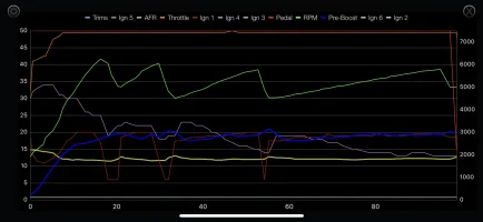

Did the BEF with great results, timing now is in the 19 to 21 range. Slight improvement with the butt dyno, but most noticeably how smoother it is under WOT. As usual and since 2018 when I first got the JB4, Terry is always very responsive and great to work with. The pop/burble in the BEF is good as well, starts at the 2k range and is loudest at around 3-4k.

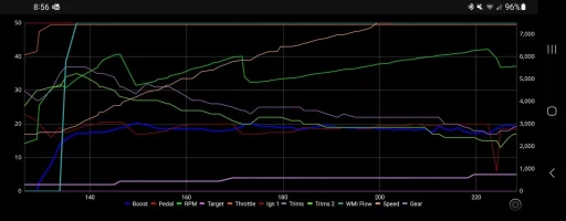

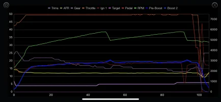

Ok, so for those that have been helping and following me through my horrible timing issues and crazy 27 lbs. of boost here's an update:
I bought an uploaded the BMS BEF flash from Terry, rest my ECU by disconnecting battery for 15 mins then drove the car around for about 100 or so miles to let the ECU re-learn. Did pulls on Map 0, 1 and 2 and sent them to Terry. The BEF was incredible and I got smooth boost that never went above 22 and the shifting was smoother and power delivery was instant. Most importantly my timing never went above 3.1 The BEF superseded the Sxth Stage 2 tune and I lost ISG disable feature. No biggie, I just jammed a piece of ziptie into the ISG button like I've been doing for the last year and a half and had the Poor Man's ISG disable set.
And then...
Nathan sent me the Stage 2 revision with reduced boost. I was hesitant to flash it into my ECU because my car was finally running smooth with the JB4 Map 2 and back end flash but another part of me didn't want to blow the $450 I had invested into the Sxth tune so I flashed it in and did some pulls with the JB4 on Map 0.
Car felt good but my timing is whacky again. Got as high as 10.5 on IGN 6. My boost went up to 24.4 and this is on 93 octane fuel from a top tier gas station. I attached the log. Is there Map 6 corrections I can make? I do have plans for CPI as I don't have faith in the fuel in Illinois. Fuel-It Kit gets installed today then getting an intercooler with CPI port then the BMS CPI kit soon.
Any help would be appreciated.

Man your car is way out of whack. send nathan that log then flash back to Terry's. Its def something with your car though. Im guessing it just has to do with terrys experience reading the JB4 data compared to nathans, cuz on the other end of the spectrum, Nathan gave me a new beta version of the stage 2 TCU tune and Methanol ECU tune and god damn.... doing some test pulls the thing feels like a rocket ship. I did a 20ish to 110ish and I swear I blinked around 70mph and missed about 10mph in that time...
