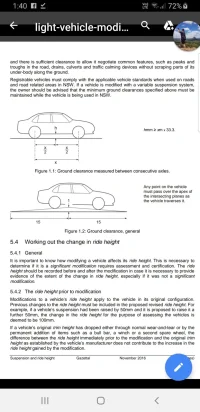

I think if the wheels are aligned properly and the camber setup the right way it would be better as far as tyre wear but I think it would still be low. I would be interested to actually test the ride height to see if it’s even legal. It looked very low. I didn’t want to panic him lol but no doubt he’ll read this so sorry in advance @Ozstung :whistle:. I’d hate to see a bunch of Stinger owners fit the springs only to get defected later by the highway patrol. I’m sure I read somewhere else where the manufacturer claimed they lower the car by a certain amount but in reality it’s actually lower once they settle. Could be an issue, but at this stage just my opinion not backed with any testing.

Width of front to back wheels from the centre divided by 2 X 33.3 = allowable lowered height according to nsw legislation
