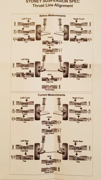

Moving on i went and got the camber aligned correctly or at least an improvement, well happy with that.

For those following my car on the meets and seen the camber here is a before and after spec sheet from todays alignment. The shop believes the guy who did the springs probably didn't do an alignment. He has since left his practise at Arndell park so i found out. The new owner wanted instructions on how to fit them! Long story short put a line through them.
