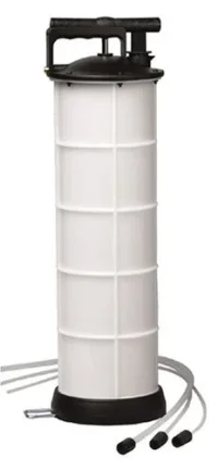

    Who goes underneath to drain oil? There's a reason filter cartridges are located on top..

    Ha Ha...thats great to get the oil out of the pan...does not help with the cartridge...NOT located on top of this engine :)
