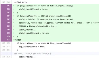

memFuture2Addr is the variable for the address in eeprom to be accessed. the error is "isg" on that line. it's supposed to be the variable "ahold"You’re writing the future state of auto hold over the eeprom value of the state for ISG (Idle Stop and Go)?

So I got pretty deep into AVR programming and I like your thoughts on interrupts vs polling. I wrote some code for an extremely low power module (note: this code includes all my latest hardware updates including optocouplers and FRAM so it may seem different)Thanks a bunch for doing the design work on this, I'm excited to try making my own.
I spent a little time this morning re-writing the software to be able to use interrupts or polling, but I haven't tested it on my car yet, so typos are likely.
A nano only has 2 interrupt capable pins, so polling would be eventually required for ISG (Idle Stop and Go) operation. Other chips like a teensy could use interrupts, but in a case like this, I think a tight polling loop is fine.
C:#include <Arduino.h> #include <EEPROM.h> // how long we need to wait between changing modes automatically (in milliseconds) #define OUTPUT_WAIT_TIME_MS 1000 // how long we need to hold the button down when changing modes automatically (in milliseconds) #define OUTPUT_PULSE_TIME_MS 250 // how long it takes the car to start up (in milliseconds) #define STARTUP_WAIT_TIME_MS 5000 // intput pins #define CW_INPUT_PIN 2 #define CCW_INPUT_PIN 3 // output pins #define CW_OUTPUT_PIN 5 #define CCW_OUTPUT_PIN 6 // enable debug messages #define DEBUG // debug print wrapper #ifdef DEBUG #define DEBUG_PRINT(x) Serial.println(x) #else #define DEBUG_PRINT(x) #endif #define INTERRUPTS //#define POLLING // memory address we store the mode in (not currently wear leveled, will handle ~100,000 mode changes) int EEPROM_ADDRESS_MODE = 0; // memory address we mark to signify first startup int EEPROM_ADDRESS_INITIAL_SETUP = 1; const byte MODE_FIRST = 0; const byte MODE_SMART = 0; const byte MODE_ECO = 1; const byte MODE_COMFORT = 2; const byte MODE_SPORT = 3; const byte MODE_CUSTOM = 4; const byte MODE_LAST = 4; const byte MODE_IMPOSSIBLE = 255; // global that stores current car mode byte currentMode = MODE_IMPOSSIBLE; // global that stores current target mode byte targetMode = MODE_IMPOSSIBLE; void update_eeprom(void) { // only update eeprom if data is different (prevent eeprom wear) if (EEPROM.read(EEPROM_ADDRESS_MODE) != currentMode) { EEPROM.write(EEPROM_ADDRESS_MODE, currentMode); DEBUG_PRINT("EEPROM Update"); DEBUG_PRINT(currentMode); } } // capture a cw physical knob turn void knob_cw(void) { currentMode -= 1; if (currentMode < MODE_FIRST) currentMode = MODE_FIRST; } // capture a ccw physical knob turn void knob_ccw(void) { currentMode += 1; if (currentMode > MODE_LAST) currentMode = MODE_LAST; } // simulate a clockwise turn of drive mode num times void clockWise(int num) { for (int i = 0; i < num; i++) { digitalWrite(CW_OUTPUT_PIN, HIGH); delay(OUTPUT_PULSE_TIME_MS); digitalWrite(CW_OUTPUT_PIN, LOW); delay(OUTPUT_PULSE_TIME_MS); DEBUG_PRINT("Automated CW"); } } // simulate a counterclockwise turn of drive mode num times void counterClockWise(int num) { for (int i = 0; i < num; i++) { digitalWrite(CCW_OUTPUT_PIN, HIGH); delay(OUTPUT_PULSE_TIME_MS); digitalWrite(CCW_OUTPUT_PIN, LOW); delay(OUTPUT_PULSE_TIME_MS); DEBUG_PRINT("Automated CCW"); } } void setup() { // must use pins 2 and 3 for interrupts on an nano pinMode(CW_INPUT_PIN, INPUT_PULLUP); // clockwise input pinMode(CCW_INPUT_PIN, INPUT_PULLUP); // counterclockwise input pinMode(CW_OUTPUT_PIN, OUTPUT); // clockwise output pinMode(CCW_OUTPUT_PIN, OUTPUT); // counterclockwise output // if this is the first use set the default drive mode, car is expected to be in comfort mode if (EEPROM.read(EEPROM_ADDRESS_INITIAL_SETUP) != 1) { DEBUG_PRINT("First Boot"); EEPROM.write(EEPROM_ADDRESS_MODE, MODE_COMFORT); EEPROM.write(EEPROM_ADDRESS_INITIAL_SETUP, 1); // mark initial setup as done targetMode = MODE_COMFORT; } else { DEBUG_PRINT("EEPROM Loaded"); targetMode = EEPROM.read(EEPROM_ADDRESS_MODE); DEBUG_PRINT(targetMode); // car remembers eco and comfort settings if (targetMode == MODE_ECO || targetMode == MODE_COMFORT) currentMode = targetMode; else currentMode = MODE_COMFORT; } #ifdef DEBUG Serial.begin(115200); #endif // wait for car to start up delay(STARTUP_WAIT_TIME_MS); // change the car mode if needed if (targetMode < currentMode) counterClockWise(currentMode - targetMode); if (targetMode > currentMode) clockWise(targetMode - currentMode); currentMode = targetMode; #ifdef INTERRUPTS // watch for the mode to change attachInterrupt(digitalPinToInterrupt(CW_INPUT_PIN), knob_cw, FALLING); attachInterrupt(digitalPinToInterrupt(CCW_INPUT_PIN), knob_ccw, FALLING); #endif } void loop() { #ifdef POLLING // poll cw static bool previous_cw = true; bool cw = digitalRead(CW_INPUT_PIN); if (cw == false && cw != previous_cw) knob_cw(); previous_cw = cw; // poll ccw static bool previous_ccw = true; bool ccw = digitalRead(CCW_INPUT_PIN); if (ccw == false && ccw != previous_ccw) knob_cw(); previous_ccw = ccw; #endif update_eeprom(); }
