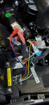

Got this installed and it works great! Thanks @budzique
