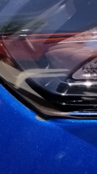

After reading these threads, I decided to check out the front bumper of my Micro Blue GT2. I found a small area of peeling, like a teardrop. Took it to my dealer and they inspected it thoroughly. The solution being implemented is a brand new bumper, painted to match of course, is on order and will be installed soon. Thus far, this is my only paint issue.
Well! They didn't waste a single moment on your issue. Impressive.
How many miles on your Stinger? Most owners say the bumper is ok except for the headlight rub.
This is due to a headlight issue. The headlight rubs the bumper. I would advise not to replace bumper until Kia has a solution. This will just happen again.
Quite a few members have same issue. New cars on lot have same issue. KIA has not mentioned a issue/fix. Has to be on radar since they read this forum.
