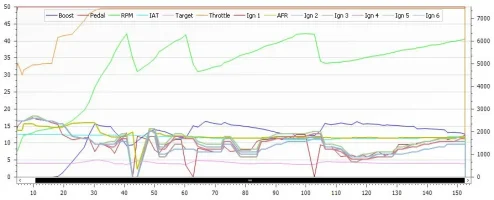

Map 2 & PetroCan 94 here. @Terry@BMS - care to look over this log and see how you feel about Petro94? I'm curious to know too.
13.19s @ ~108mph @ 2200ft / 2995 DA, AWD, FYI. IAT probably plays a role in the fact it wasn't in the 12's?
Sorry for delay!
Looking at timing it's roughly the same in each cylinder so that indicates the octane is generally sufficient for the boost target. The DA and IAT are certainly slowing it down a bit. Although I'd expect more like 110mph+ than 108mph here. I'd suggest trying map3.

OK do it! The main thing is to look at timing cyl1-6 on the different fuels to check for variances.
For track stuff you can also use a dragy to test under various conditions to confirm if the car is running slower than it should be or if it's perfectly normal and just the specific track conditions you were racing under that day.

So this data isn't incredibly conclusive since runs were performed in different locations, different days, etc, but I thought I would present some summed findings from my logs.
Things to note is that this data was extrapolated from Excel, using =average calculations, etc. I considered the 0-60 run starting from the last row of cells with 0mph before the speed went up, and ended the run at the logged 60mph cells. Average ignition is a little lower since the car dumps ignition to zero for two rows of cells when shifting from first to second gear, and also there is boost ramp-up in first gear since this is a 0-60, which brings down the average boost value as well.

If you want to measure performance really a dragy is going to be needed using a measure that takes traction out of the equation like 1/4 mile traps or 50-100mph. But if you need to do it another way you can do fixed gear pulls in say 4th gear starting at 1500rpm to redline, and then in the logs compare the time passed during each from 2000rpm to some specific stopping RPM, along the X axis (tenths of a second).
Of course, the 0-60 logs are a big "for what it's worth" considering when I examined them, my Husky 94 run SHOULD have been faster if everything else was equal and the same otherwise. I don't get out to do high speed testing often. The biggest factor is the wife doesn't get it and I don't feel like explaining it, lol. I'm too nice I guess.
I hear you. :)
The logs will be useful too so you can look at timing advance in cyl 1-6 under the same conditions for both fuels. If the performance is similar but one fuel has better timing.. It's a good indication to stick with that fuel.
