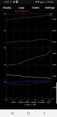

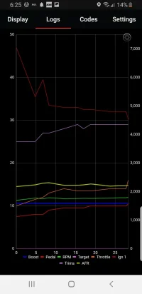

Just installed JB4 fuel wires and harnesses and mobile connect. Connected mobility perfect. Took a short drive map1 horrible backfires half to full throttle. Didnt even think it was possible to log. Switched to map 0 runs fine.
Changed plugs gapped to .022 purchased bms kit. Installed all wiring connected to phone and took short drive.
Did I forget anything? Was I supposed to do anything else? Does firmware need upgraded figured it came updated
Any help? Thanks Rob

Map1

Map 0
