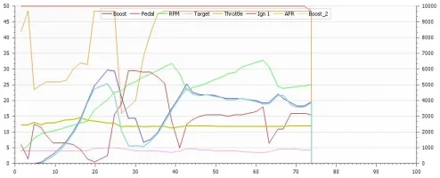

Can you show a typical log?
BTW the actual boost that went past the throttlebody is Boost2 = 21.9psi at max (at least from what the logging sampling rate allows to see).
The boost at 4100 RPM reads out to be 29.7, this is the highest I've ever seen it go. Should I be concerned?

2.0L Stinger w/ Intake, JB4 with Fuel Wires, BOV, Muffler Delete, 93 Octane on Map2.
Grab a similar log on map0 for comparison.
