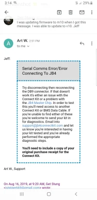

The car runs fine, I doubt there is an issue at all. I got the error while updating firmware, reconnected and updated to v10. I think I'm good to go. Should I be concerned?Just means app isn't able to connect. Could be for a variety of reasons. Power wire loose on JB4 mobile adapter, water damage to JB4 mobile adapter or JB4 board, loose pin on the DB9, issue with phone to JB4 adapter connection, 2580 chipset was static zapped, etc.
JB4 mobile is a 3rd party part so they have their own support team.

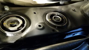

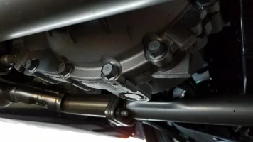

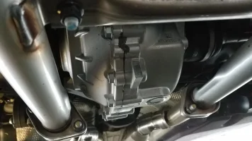

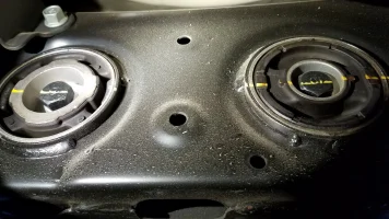

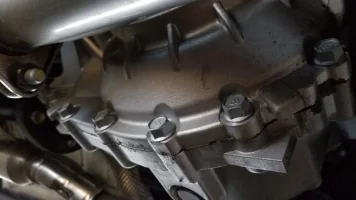

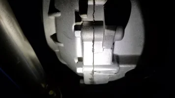

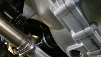

It might we just don't have a awd car handy to test fit on.
Have you had anyone offer yet? How long do you need the car? I'm in NorCal, but we're thinking of a trip down there in a month or so..
I'd settle for a good photo to see if it looks the same as the RWD.
Does it require removal of an under-panel?
Not on RWD.
@Terry@BMS - any feedback on the pics?
