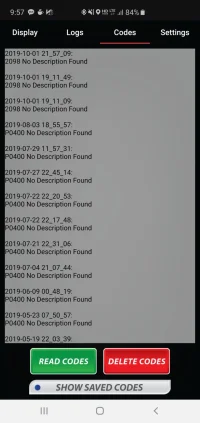

Did you change something in the last firmware regarding CEL codes?
I used to have a P0400 with my downpipes but now I got a P2098. It may be related to my recent upgrade of intake filters, but its been a long time since I didn't have a code so I wondered if anything changed on JB4 side.
You can search codes on google for descriptions and general ideas of what might be causing them. O2 sensor issue, exhaust leak, E85 mixtures, etc. Not a major code but also not a normal downpipe code.
What would be a normal downpipe code?
I think I was running lean because I changed the intake filter to a bigger one. Need time for the ECU to adapt.

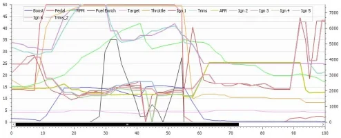

@Terry@BMS Can you look at my logs and see if everything is good? I only went from a rolling start to like 65 MPH. Running on 91 Octane. All stock other than Denso spark plugs.
Looks fine to me
