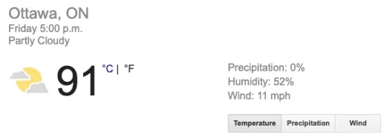

Clearly, you've never been in south-western ontario during the summer.. Maybe 10 degrees cooler, and a bit less humid at night, but.. Tomorrow, the forecast is 95F + thunderstorm with humidity making it feel well into the 100s for one I looked up. I grew up there - now I live in "COLD" Northern California :) Las Vegas at 110 is more bearable than Ontario at 95.
My bad, I thought that Canada was colder all year around. :p
In Canada I don't think you will ever have such problems. :D
FYI
Also, Ottawa is 150 miles south of Seattle by latitude, Windsor is 350 miles south of Seattle :) Can't speak for those up in Edmonton who might as well be in the arctic circle, it's 67F there today :confused:

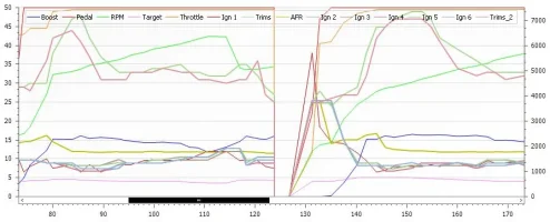

Here is a log of the pull that triggered the engine overheat warning.
PS: Ignore the funky RPM in the middle, I just shifted too early in gear 5.
I really wish that JB4 could show Engine oil and Trans. Temps since we can't use third party OBD gauges.

Got a few wot in this log, never got any logs reviewed so would like to know if map 2 running well and can maybe try map 3? (I can get octand booster if needed, but wondering if i need it)
-stinger awd gt2 (canada), 91 octane, jb4, densos, k&n CAI, gfb respons BOV, ark SdP, borla cat back, OCC
I don't think that you can run Map3 with this octane (looking at the logs), but its better to wait Terry's opinion.
Short run but seems OK to me. For 91 octane I'd keep it on map2.
