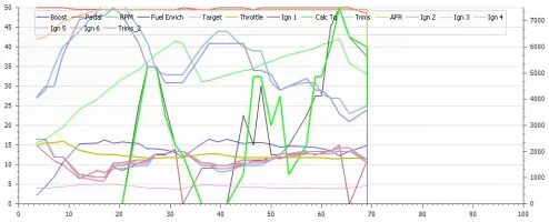

I tried running map 3 with 93 octane plus Lucas octane booster, the car would not go past 5k RPM on WOT. Was the octane booster bad or was it something else?
Would need a JB4 log for any tuning advice.

@Terry@BMS yBMS, another newb here. Wanted to send you a few logs to look over. I just installed the jb4 a few days ago. I have been reading the forums and I think I found the answers to my main question. I believe I am experiencing oscillations like others. I can feel it in the car, hear it, and see it on the trends. What's strange is that I'm seeing it on map 1, most other other guys see it on higher maps. I mainly see it when in comfort mode. I dont really notice it in sport mode. I'm in the Houston TX area and running 93 octane. Can you please take a look at these logs and see how things are looking before I go to map2. Also, I updated the firmware to version 9 as soon as I installed everything. I'm ready to try out map 2.

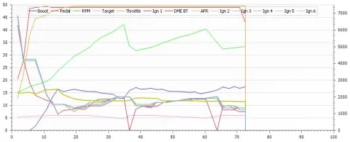

Hi, ordered my JB4 with bluetooth and denso plugs a couple weeks ago and finally had time to set everything up yesterday. Everything else on the car is stock, AWD 3.3T. Can you check out the attached logs to make sure all looks good? Map 1 and 2, JB4 FW9
For fuel im running 15 liters of E85 to a full tank of 87 octane. My works re-emburses me for 87 so i wanted to see if i can make this combo work as a daily driving mix. My calculations put it around e25-30 and 91 octane. I want to try out Map 3 and was wondering what values in the log i should watch out for? i didn't see a knock sensor column.
Also, tried search for this but couldn't find it, how can i confirm the fuel wires are working correctly? I know that you don't need to enable them with the new firmware.

Map2 looks good so far. On fuel wires I can tell by looking at fuel trims, fuel wires are working properly here. For knock you look at all 6 cylinders and look for repeated same cylinder drops indicating the ECU is having to continually pull back timing in one specific cylinder. When you see that then it's time to up the octane, back down the boost, or in some cases (like lower grade fuels) decide to live with it.
Awesome, thanks for the prompt response! I'll try Map 3 out tonight.

How do my map 3 logs look? I also noticed i get the oscillating boost feeling occasionally on map 2. i read on one of your previous posts to use FutureUseD bit7? what does that do? any other recommendations? Hopefully it's something the JB4 can eventually fix. don'y think it's captured in these logs.
Map3 looks fine. If you have an issue at part throttle fud.7 will change the pedal to boost relationship to be more linear and may be preferable.
