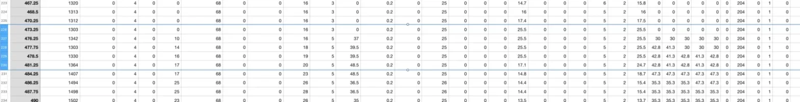

Hi @Terry@BMS
I did some ECO mode driving tonight and pulls some logs. Could you take a peek at them? Car felt a LITTLE bit sluggish when commuting today. Maybe it's in my head.... Maybe the small gap? I dunno.
Sometimes I see my AFR spike to 25.5. Also see the ign timing dip from 25 to 11 for no apparent reason.
I attached a screen shot of the AFR spikes.
Thank you so much for everything you do for us!

Terry will give you the best advice but there are a couple obvious things that may help.
The main “sluggish” problem is likely just from using ECO mode. That’s kinda like putting low octane regular gas(87) in your tank and wondering why it doesn’t perform well.o_O ECO mode intentionally prevents boost & RPM from building to save on gas. This is probably confusing and working against the JB4 which is trying to increase boost based on throttle input, etc. Even Comfort mode has some of those “sluggish” effects because the TCU tends to shifts gears too early while it’s just starting to build boost. Sport mode seems to work best since the TCU will hold gears and stay in sinc with the JB4s extra boost, etc.
Also, your logs don’t help much since your not doing WOT runs to see how everything is performing. You don’t go over 50% pedal input and most of the log is at 0psi so your AFR and IGN are fluctuating. The JB4 doesn’t even start altering parameters until a certain pedal input so most of your logs aren’t useful for analysis.
You need a few WOT logs to show true AFR, IGN and boost results that can be analyzed properly. Hope this helps and happy tuning.:thumbup:

Not much to look at, just a couple half throttle runs? Eco is sluggish by design.
AFR goes to infinity when letting off the gas as fuel is cut off, JB4 logging caps the reading at 25:1.
