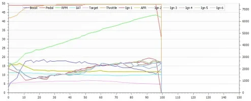

Hey Terry, could you take a look at my logs and see if anything odd is going on? I hit the dyno and the curves came out pretty weird, instantaneous torque followed by a massive drop off. All the logs are from the dyno runs.

Limp mode? Over boosting? What mods are you running?

JB4 + fuel wires, SSR midpipes, K&N intake, TurboXS BOV. I've got a sneaking suspicion there's a boost leak at the BOVs

That was my first guess. Put your stock diverter valves back on and see what you get.
Yeah boost seems to be down 2-3psi from what I'd expect at peak HP.

Are you confident the dyno was operating properly? Are there any other runs from the same day to compare on that end? To be honest your logs look perfect to me....
  • Boost is where it should be (18 peak, 16-17 midrange, then tapering down)
  • Timing is where it should be (steady ramp up to ~20 degrees, although ign2 takes a drop around 6100rpm on map 5)
  • AFR is steady (11.8-11.9)
Would a 2-3 psi loss really drop power THAT much? That curve looks crazy weird.

The map 0 run resulted in 320/425 which is really confusing because that's major torque bump, but dead on for stock HP; can't speak to other peoples runs at this shop, but they're super popular.
