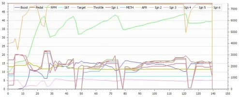

The FUD setting helped, but oscillations are still noticeable with firmware 6-8.The FUD setting is only effective for partial throttle oscillation.
Stock intakes would reduce power/boost potential, so would certainly have an effect. As would running a lower boost target in the engine speed range effected.
No luck on EWG control yet. IAT control might be useful though.
So any bolt-on upgrades that increase power/boost potential will cause oscillations? Wouldn’t everyone with intakes or power adding mods have the same issues?
Also, changing to a lower boost target doesn’t help. Same boost issues on map1 as map2.
Nothing seems to eliminate the oscillations except reverting back to firmware 4 or 5. Unfortunately then you lose the double-PID fuel control and other great features.
IAT control would help in warn FL weather? I thought that was for helping people in cold weather?
Feel like we’re close to resolving the problem and hopefully just one more setting away from perfection!
