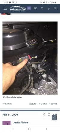

K got the fuel wire done way easy. Use the long wire go straight to the white wire and thats it!!! Here is a pic. Also my dumb ass should have went back to the start of this post on this forum we are on? It has it all but guy this morning with real pics helped alot.

Good pic, "bosaad". The pics on the link at the BMS site are for the 3.3 BUT they are essentially in the same position and are the same sensors. Again, i have the 2.0T and the HKS plugs and they were recommended to gap at 0.022. That is where mine have been since day one (about 4 months ago) and the spare set i purchased were gapped to the same measurement. No issues at all with the plugs. BMS didn't have the plugs for the 2.0 which is why i went HKS straight from the big "A"....Amazon. got them in 3 days but they sell out fast!!!!!
Nice! Terry is going to be getting a hold of me tomorrow I've been talking with Chris today at BMS after I had it up and running. Also waiting on gap tool to press the tab down so I get it perfect when gapping the auto store one or pliers did okay but not perfect, that will be here tomorrow so I can get it to spec the lowest I could get em was .024 Other then that thing runs way good and on map 2 man o man! Wish they came off the lot like that, So much better! Again thanks for your help. I was just gun shy at first. Terry is already gunna do some logging for me. And help out on a few ?s I have with the fuel line and the canbus cable. That Chris couldn't answer.
