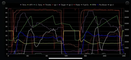

HKS M45XL Plugs (didn't gap them, will see how things work like this, if there's any little issue, will gap. Did some Logs with the JB4 and all were looking good as I got amazingly fast feedbacks from the guys, cheers to them for that!

This is crazy. Map 1 is MORE than enough for me, it has such a big boost and car feels so snappy. Map 2 is crazy good but ain't gonna use it that often. And Map 3 is a total overkiller, I'm actually pretty scared to use it
Tried it once and JB4 got me back to Map 0 (protection) so I guess that was a no-no for me (probably because I was running 98+ gas). Now I'm on 100+ and Map 1 should be a daily all good to be driven.
