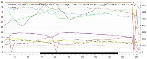

And then finally the good stuff, how does it actually work? Here is a sneak peak of a JB4 log recorded on 91 octane using boost juice (50/50 mix). As the JB4 is running WMI mapping it can control how much flows, when it flows, and how the tuning responds when it's flowing. You'll notice I have it set not to spray in 1st gear here as JB4 boost is reduced for improved traction. You can see the meth flow trace in the log as well as intake temperatures dropping. This specific log resulted in a 12.4@116mph 1/4 mile.
attachment.php
Do you have before and after iat temps? How much more boost are you running under meth flow?
map8 is setup to transition between map1 power levels and map7 power levels currently as a function of WMI flow. Now that it's up and running will continue refining the software side. Expect to see more logs and photos posted as we go. :)
