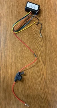

1. The instructions say "The FSB red power wire will be routed to an inline fuse using a wire nut for attachment, and then the inline fuse routed in to an unused spot in the fuse box." The picture shows a wire nut being used but I don't understand why. My fuse and the wire that needs to go to the fuse box are already attached.
2. Which unused fuse location is best to use or will any of them work? The instructions say " we strongly suggest SWITCHED power for the FSB. Resist the urge to use the easy to reach/attach to CONSTANT power sources" so I want to be sure I use the correct one.

Thanks for the answers. There is no separate red wire with the kit I received. See the picture below. I am guessing they changed up the kit and now it comes pre attached. It looks like mine has already been heat shrunk together I just wanted to make sure I wasn't missing something since the instructions differ slightly from what I received.
I know I can break out the tester and find one that's not constant but I thought it would be faster just to ask someone who had already found it so I didn't have to go through the process.
I know you aren't trying to be mean and I appreciate the answers. Other than the questions I asked the install seems straight forward so I don't anticipate any issues.
Nice! Mine was separate so I use quick disconnects on a bunch of connections, it is pretty straight forward. I literally used the same spot as the picture in the instructions for the install. It's a non constant source.
